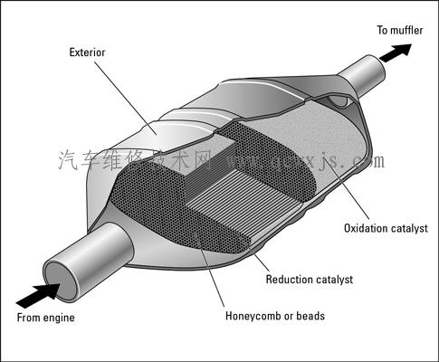

interior and exterior views of a catalytic converter.interior and exterior views of a catalytic converter.here are five signs that something may be wrong with your catalytic converter:
